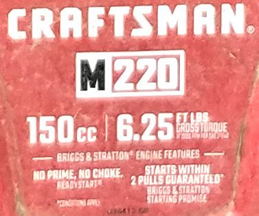

My Craftsman M220 mower (picture at bottom) has torque on it, not hp.   The motor is Briggs and Stratton.
A lot of sites say, "You can convert torque to horsepower by multiplying the torque rating by RPMs of the mower and dividing by 5,250. Now you can compare horsepower to horsepower.
The small print under the FT LBS Gross Torgue on the red label at bottom say 2600 rpm.
6.25 x 2600/5250 = 3 hp

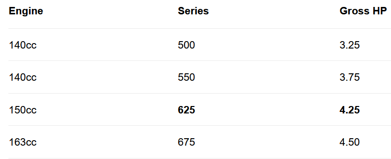

But the first table below says a 150 cc Briggs and Stratton has 4.25 hp.

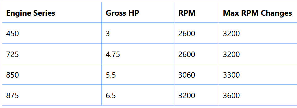

Note that 6.25 x 3600/5250 = 4.28 hp and the article the bottom table comes from says for Briggs and Stratton, "most of its series offer gross HP ratings at 3000 to 3600."
So I guess I have a 4.25 max. hp that normally operates at 3 hp: it doesn't come with a throttle but would increase hp when it was cutting through stuff without losing to many rpms.   It self-propels at speeds fast speeds but does slow down a little in tough grass.

462204871_LawnmowerLabelCloseup.jpg.e125441218cb1442d3b3920329e13cdf.jpg 921907609_LawnmowerOnlinePic.jpg.35ece0f4425a5f658e3bd9a9d5dd605a.jpg

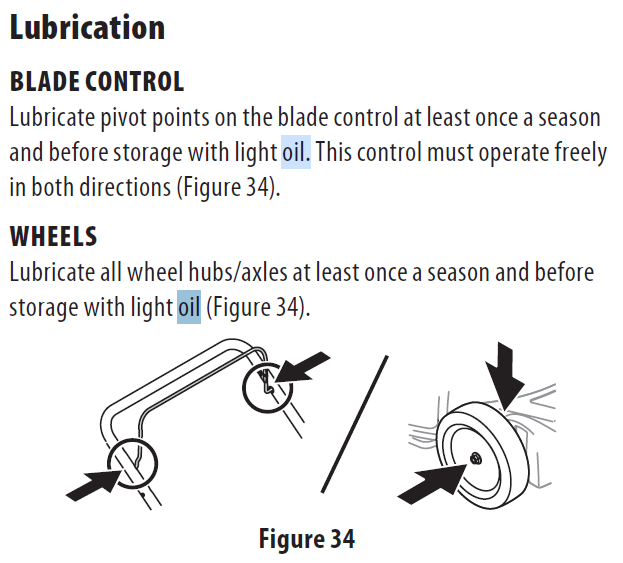

I just looked up the manual for mine and there's all kind of lubrication I've been skipping.   I doesn't say anything about changing the oil and there's no oil filter but a manual for a smaller Craftsman mower says to change the oil after every 50 hours of use.

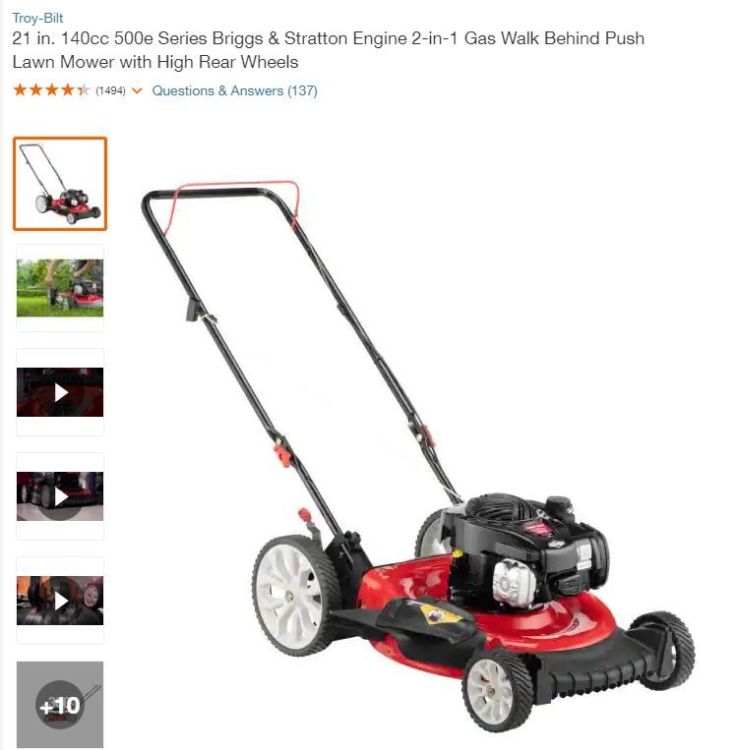

This is the mower I am contemplating buying right now.   My old Sears Craftsman mower is on it's last legs, I'm afeerd.
B&S "no oil change" engine.
I wish I would have bought a wider than the standard 21”. But the price goes up quickly.
